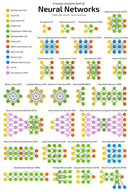

See the following chart that depicts the several neural-networks architectures including deep-conventional-neural-networks: visualization.

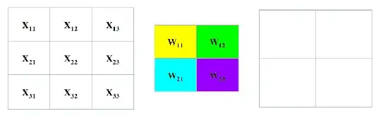

Hence in Machine Learning, a convolution is a sliding window across an input creating one averaged output for each stride the window takes. I.e. the values covered by the window are convoluted to create one convoluted output. This is best demonstrated with an a diagram:

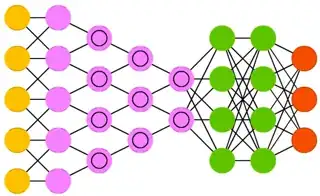

If the window is greater than size 1x1, the output will be necessarily smaller than the input (unless the input is artificially 'padded' with zeros), and hence CNN's often have a distinctive 'funnel' shape:

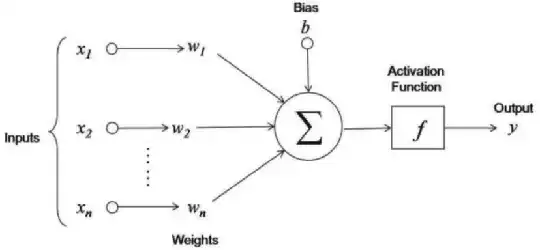

A neural network (Multiple Layer Perceptron: Regular neural network ): It does a linear combination (a mathematical operation) between the previous layer's output and the current layer's weights(vectors) and then it passes data to the next layer by passing through an activation function. The picture shows a unit of a layer.
A normal neural network. w represent weight

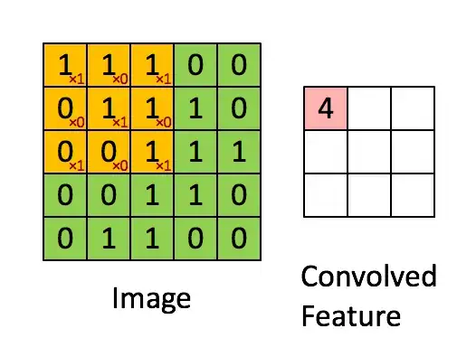

A neural network (Convolutional Neural Network): It does convolution (In signal processing it's known as Correlation) (Its a mathematical operation) between the previous layer's output and the current layer's kernel ( a small matrix ) and then it passes data to the next layer by passing through an activation function. The picture shows a Convolution operation. Each layer may have many convolution operation
