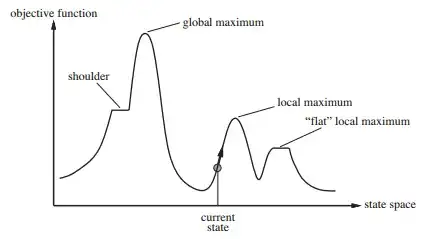

As @Philippe Oliver said, you could have several problems using just "Hill Climbing" like:
  • Local minimums.
  • Flat local minimums.
From "Artificial Intelligence: A Modern Approach (3rd Edition)"
You can have more information on: Artificial Intelligence: A Modern Approach (3rd Edition) by Stuart Russell and Peter Norvig.
