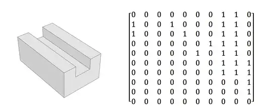

I am trying to develop a neural network which can identify design features in CAD models (i.e. slots, bosses, holes, pockets, steps).
The input data I intend to use for the network is a n x n matrix (where n is the number of faces in the CAD model). A '1' in the top right triangle in the matrix represents a convex relationship between two faces and a '1' in the bottom left triangle represents a concave relationship. A zero in both positions means the faces are not adjacent. The image below gives an example of such a matrix. enter image description here
Lets say I set the maximum model size to 20 faces and apply padding for anything smaller than that in order to make the inputs to the network a constant size.
I want to be able to recognise 5 different design features and would therefore have 5 output neurons - [slot, pocket, hole, boss, step]
Would I be right in saying that this becomes a sort of 'pattern recognition' problem? For example, if I supply the network with a number of training models - along with labels which describe the design feature which exists in the model, would the network learn to recognise specific adjacency patterns represented in the matrix which relate to certain design features?
I am a complete beginner in machine learning and I am trying to get a handle on whether this approach will work or not - if any more info is needed to understand the problem leave a comment. Any input or help would be appreciated, thanks.

  • As far as I understand, yes your problem is related to pattern recognition. Since the approach is to classify inputs with labels you previously provide for the neural net, I think a convolutional neural networks could work for you problem. – Bitzel Jan 23 '18 at 05:01
Technically, yes. In practice: no.
I think you might be interpreting the term "pattern recognition" a bit too literal. Even though wikipedia defines Pattern recognition as "a branch of machine learning that focuses on the recognition of patterns and regularities in data", it's not about solving problems that can "easily" be deduced by logical reasoning.
E.g. you say that
This is true always. In a typical machine learning situation, you wouldn't (usually) have this prior knowledge. At least not to the extent that it would b be tractable to “solve by hand”.
Pattern recognition is conventionally a statistical approach to solving problems when they get too complex to analyze with conventional logical reasoning and simpler regression models. Wikipedia also states (with a source) that pattern recognition "in some cases considered to be nearly synonymous with machine learning".
That being said: you could use pattern recognition on this problem. However, it seems like overkill in this case. Your problem, as far as I can understand, has an actual "analytical" solution. That is: you can, by logic, get a 100% correct result all the time. Machine learning algorithms could, in theory, also do this, and in that case, and this branch of ML is referred to as Meta Modelling[1].
In a word: Probably. Best way to go? Probably not. Why not, you ask?
There is always the possibility that your model doesn't learn exactly what you want. In addition you have many challenges like overfitting that you'd need to concern yourself about. It's a statistical approach, as I said. Even if it classifies all your test data as 100% correct, there is no way (unless you check the insanely intractable maths) to be 100% sure that it will always classify correctly. I further suspect that you're also likely to end up spending more time working on your model then the time it would take to just deduce the logic.
I also disagree with @Bitzel: I would not do a CNN (convolutional neural network) on this. CNNs are used when you want to look at specific parts of the matrix, and the relation and connectedness between the pixels are important — for example on images. Since you only have 1s and 0s, I strongly suspect that a CNN would be vastly overkill. And with all the sparsity (many zeros) you’d end up with a lot of zeros in the convolutions.
I'd actually suggest a plain vanilla (feed forward) neural network, which, despite the sparsity, I think will be able to do this classification pretty easily.
