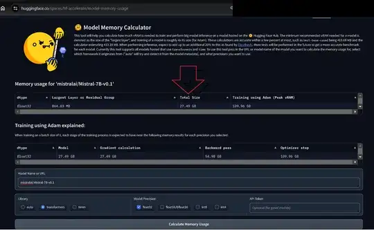

(V)RAM requirement for inference: Model size < RAM requirements < Model size * 1.2.
https://huggingface.co/spaces/hf-accelerate/model-memory-usage is helpful, e.g.:
