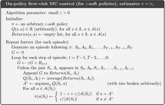

But my implementation finds V(s) = 1 for FV, because it considers a first-visit to the state to be the one visited in the backwards iteration implementation of the algorithm, not the actual order in which the state occurs in the given episode.
I assume the correct implementation should consider the natural order in which the state first occurs in the episode, even if we are iterating backwards for efficiency reasons (though I can't defend this assumption). I couldn't see this from the pseudocode, it is quite ambigous, since if we trace it (below, taken from the book), it seems like when interpreted literally, V(s) should = 1 in this example.

I assume the correct implementation should consider the natural order in which the state first occurs in the episode, even if we are iterating backwards for efficiency reasons (though I can't defend this assumption). I couldn't see this from the pseudocode, it is quite ambiguous
(It's been a long time since I studied these algorithms, but let's see if can help you.)
That pseudo-code tells you unless $S_t, A_t$ appear in the sequence from $0$ to $t-1$. Still, we iterate from $T$ to $0$, but does it really matter? We need to follow the symbols and their meanings.
Now, the problem here is interpreting that unless (horrible word because it's sometimes used to mean the opposites).
Does it mean that the code is executed
  1. if $S_t, A_t$ is in the sequence from $0$ to $t-1$, or
  2. if $S_t, A_t$ is not in that sequence
If we execute that code block if it's not in that sequence (option 2), that means that $S_t, A_t$ is the first time we encounter this pair using the natural order, i.e. the order we visited the states during the episode.
If we execute the code if it is in that sequence (first option), then we might execute that code more than once (and exactly the number of times we encounter that pair minus 1), so that doesn't look like first-visit.

Backward iteration algo above only simplifies the computation of cumulative return $G$ from any step $t$ since you only need to add the experienced reward of the current step to the previously computed $G$ as value estimates for every state in a backward fashion, eliminating the need to recompute $G$ up to the end of an episode for every first-visited state if you're using the first-visit MC implementation.
However, your exercise 5.5 clearly suggests that this backward iteration algo shouldn't change the natural order in any episode to count as the first-visit of a state which obviously affects its value estimate via the accumulative computation of $G$ which happens at every step of any episode in your referenced pseudocode. Therefore you need to focus on the correct condition in above pseudocode to count as the first-visited state in natural order within the backward iteration. Take the example of exercise 5.5, when $t=T-1=9$, the state-action pair $(s_9, a_9) = (s, a)$ does appear in the episodic sequence $(s_0, a_0, s_1, a_1, ..., s_8, a_8) = (s, a, s, a, ..., s, a)$ since there's only a single nonterminal state $s$ and a single action $a$ given in this exercise. So only until step $t=0$, the first-visited state condition is really satisfied and now you enter the final block to get the state value or action value depending on your goal. We can use below python code to show how to code up the critical first-visit state condition to arrive at the correct value function $V(s)=10$ in the one episode described in exercise 5.5.
