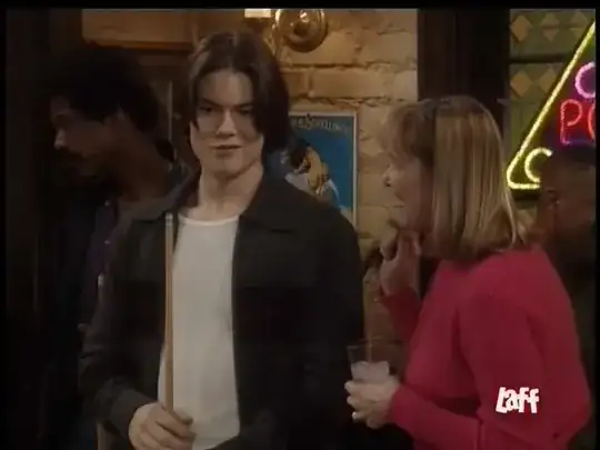

I am trying to detect a TV channel logo inside a video file. So, simply, given an input .mp4 video, detect if it has that logo present in a specific frame, say the first frame, or not.
Here's the first example of a frame with a logo.
Here's the second example.
We have that logo in advance (although might not be %100 of the same size) and the location is always fixed.
