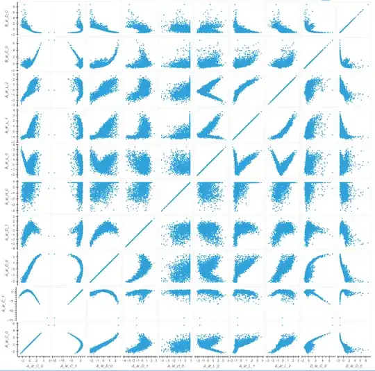

I am trying to train a variational auto-encoder where x ≈ f_VAE(x) = x_hat. In my real problem, I have 100-400 dimensional data that I would like to compress to around 30 latent variables. For now I have a toy problem where I have 14 dimensional data that I would like to compress to 7 dimensions. All dimensions are real numbers and have been standardized (zero mean, unit standard deviation). To give some idea of the data here is a scatter plot: enter image description here
