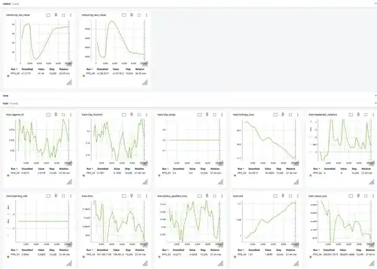

Here are the metrics for a PPO try with 10k steps: PPO 10k steps

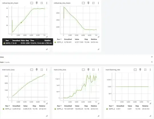

For DDPG I used the default values of SB3 and I got this: DDPG try

Looking at the episodic reward and the episodic length, they seem to be inversely related. Longer episodes have a lower reward and vice versa. The proportional penalty at each timestep might be so large that it overshadows the effect of the +/-10 for the successful and unsuccessful case. Perhaps you could consider reducing its scale.
