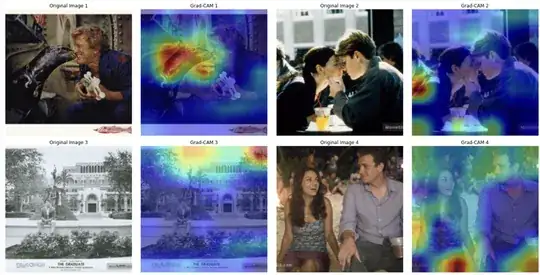

I've been investigating what exactly the model does to accomplish this. I tried Grad-CAM, which suggested the model is not looking at higher-level features of the image like faces, etc. -- that's about what I expected. enter image description here
Presumably it's instead picking up artifacts from the filmmaking process that reliably vary across time like film grain. But I've struggled to visualize what exactly those are.

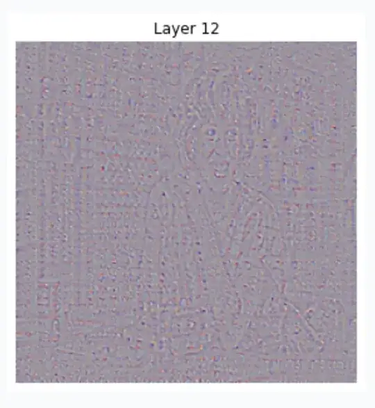

I've also looked at using a deconvnet like in this paper (https://arxiv.org/pdf/1311.2901) that's referenced in fast.ai -- but the results from that aren't easy to interpret:

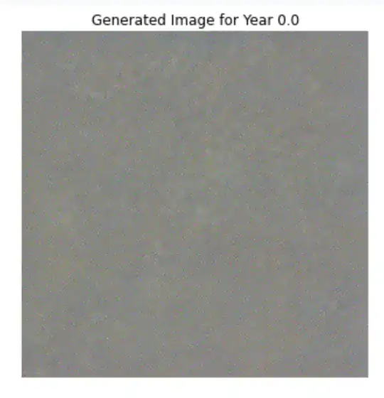

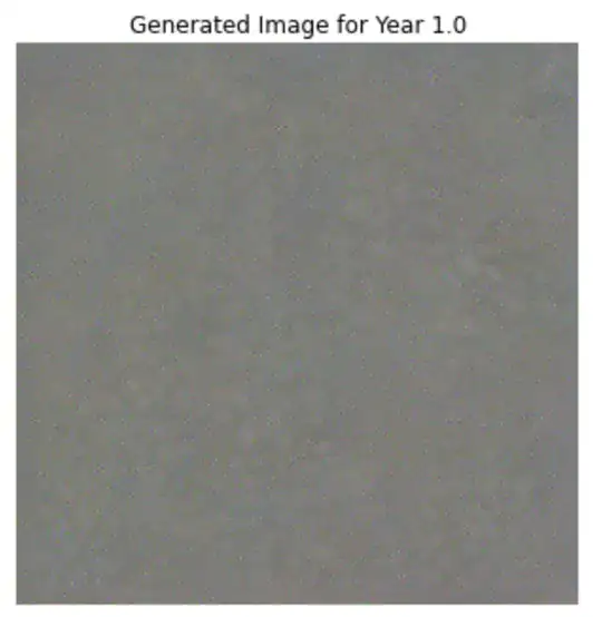

My last attempt was to optimize random noise toward the min/max years in the dataset, but the results from that are basically indistinguishable.
Any ideas for a next attempt?
