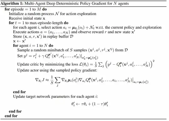

I am trying to implement MADDPG from scratch i finished the code but after 3000 episodes I still don't see any improvement on the behaviour of the agent could someone please help me. Thank you in advance ! Here is the code of my train function.

maddpg algorithm from the paper
