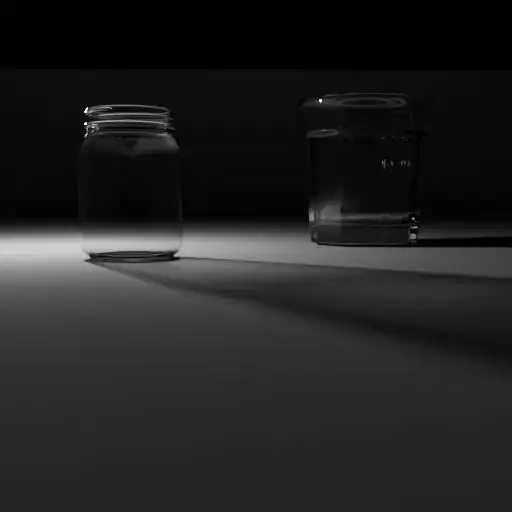

I'm training a UNet to try and predict caustics, kind of as a toy problem.
An input image to the UNet is something like this:

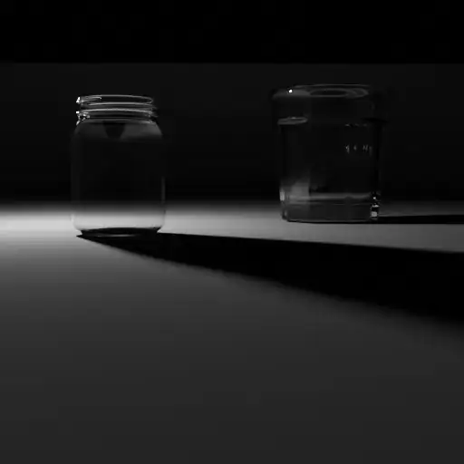

It is trained on "ground truth" outputs like this:

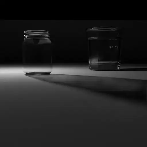

It is currently predicting results like this:
I figure I've begun overfitting because the training loss is consistently dropping below the validation loss (I'm just using standard MSE over the pixels). So, my main question is: what part of the UNet architecture is producing this weird splotchiness? It almost seems like there's some visible grid in the predicted caustic...

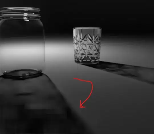

It seems like the splotchiness is similar to the that seen on the images in this question.

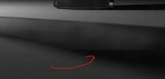

Here's another example: enter image description here
My UNet is very standard. I'm trying to think what part of it would produce this grid-like splotchiness and then how I can tackle that.
