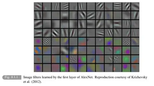

After reading on Transposed Convolutions and Fully Convolutional Networks in the d2l book (14.10 and 14.11), I wondered about the visualization of transposed convolutions. As you probably know, randomly initialized convolutional kernels learn to detect different shapes, see e.g. Fig. 8.1.1 from p.271 of the book: p.271 in the book The obvious question I then had is: What do the trained/learned transposed convolutions look like?

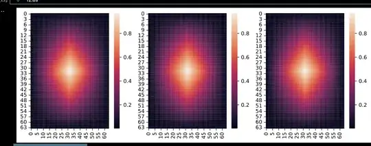

Firstly, initialization seems to play a much larger role; in the book, they are initialized so that they do bilinear interpolation, see enter image description here But then, after training, if I plot them again, all of the transposed convolutional kernels still look the same (yet their parameters changed slightly, but the network seemed to like to bilinear interpolation a lot).
