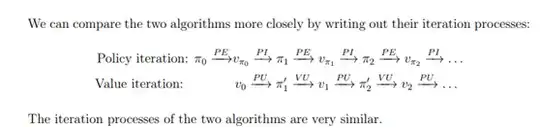

Finally note the $v_k, v_{k+1}$ in your value iteration are not state values themselves because there's no policy evaluation based on state value here at all, thus you cannot rely on policy improvement theorem to prove convergence. To prove convergence of value iteration as hinted above you need BOE and its contraction mapping fixed point theorem to step-by-step prove the uniqueness and convergence of its iterative solution which is entirely another question. There's a diagram from Zhao's Mathematical Foundation of Reinforcement Learning to illustrate the non-conflict relation between value iteration and policy iteration as follows: enter image description here
And the same reference specifically warned:
One problem of value iteration that may confuse beginners is whether $v_k$ is a state value. The answer is no although $v_k$ converges to the optimal state value $v_*$ eventually. That is because $v_k$ is not guaranteed to satisfy any Bellman equation... This might be one of the most confusing problems for beginners studying this algorithm. It is easier if we simply treat them as intermediate variables that emerge when solving the BOE.
That's why strictly speaking one shouldn't say policy improve (PI) in value iteration since there's no policy improvement theorem without state values evaluation (note all $v_k$'s in value iteration has no subscript $\pi$ compared to policy iteration), one should only say policy update (PU) in value iteration though it's also consistent with GPI (generalized policy iteration) as shown in above diagram.
