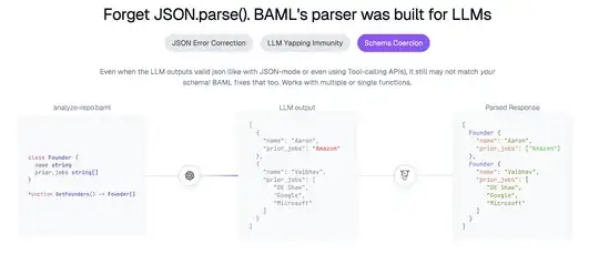

EDIT: Actual Solution
Note: For more in-depth understanding, please read the excellent post Schema Alligned Parsing
And for comparing different structured output generation methods, read https://www.boundaryml.com/blog/structured-output-from-llms
BAML worked perfectly for me
More specifically, I wrote this definition
class Resume {
  skills string[] @description("Only include programming languages")
then BAML handled communication with the LLM (both prompt generation and parsing of the prompt completion result by the LLM)
all of this got parsed into a list of strings.
