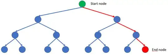

Let us consider the following graph, with the start node in green and the end node (the goal) in red. enter image description here
The solution is given by the red path.
But, in my perspective, in this scenario, in the worst case, the algorithm would try every path from the root to each leaf, and store all the nodes in the explored set.
Thus, if we consider this, the space complexity is, at least, proportional to $O(b^m)$.
Is there something wrong with this reasoning?

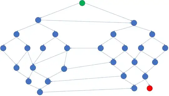

I'm including another image to represent better the searching process on a graph. enter image description here

If you have looked through an entire branch, you only need to mark off the top node for that branch.
