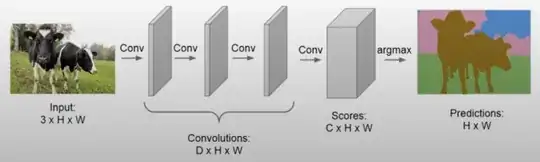

For example, why would the architecture shown below be a bad choice:

There is never a 100% accurate theory, however it's been observed to be beneficial, however I would argue that is due to the following:
  • you want to have a latent dimension, to learn the manifold compressed version, so that the decoder has a harder life to overfit (kinda speculative)
  • when doing convolution, you can keep the height and width dimensions constant, by introducing artifacts (which obviously you don't really want), so you are forced to decrease the dimensionality in H and W... so as a trade off, you just compensate with the number of filters/channels
in other words, there is no correct answer, just empirical evidence that this "latent compressed version" works better in some cases
