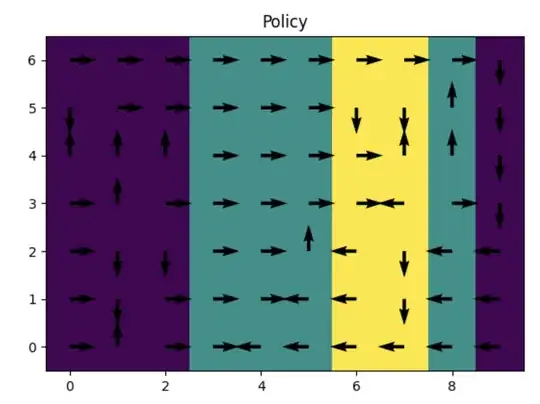

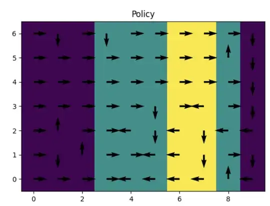

If I create a policy using the q-values of an epsilon greedy policy using the Sarsa algorithm (not changing the epsilon with each episode), will it converge to the optimal solution to the MDP? I am observing that sometimes it does not. Specifically, example 6.5 in Introduction to RL by Sutton and Barto, when I run Sarsa for 500 episodes and form a greedy policy (no exploration after 500 episodes) using the Q-values of epsilon greedy policy, I am getting different results. Is the reason for suboptimal solution that we are converging the Q values to the estimates of next state action which could be random in case of epsilon greedy (with no epsilon decay)?
Here are the two greedy policies (from epsilon greedy policy iterated for 500 episodes) with two different runs of Sarsa:
Policy 1 Policy 2
