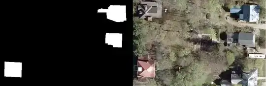

I am wondering if it is required or not that the masks used for binary instance segmentation are complete.
For instance, I want to find the buildings in aerial imagery. If my masks cover, let say between 25% and 75% of the training image buildings, can these samples be used for training the model? Does the masks should cover 100% of the buildings in the samples?
I know it would be better to mask all buildings, but if the mask is not complete, can it be used for training or not?
I am using a deeplabv3 model.
Here an example of what I mean enter image description here
You can train a model with that dataset, but it will perform worse compared to a higher fidelity dataset. Training on images with unannotated buildings is essentially instructing the model to stochastically ignore buildings, which is confusing.
