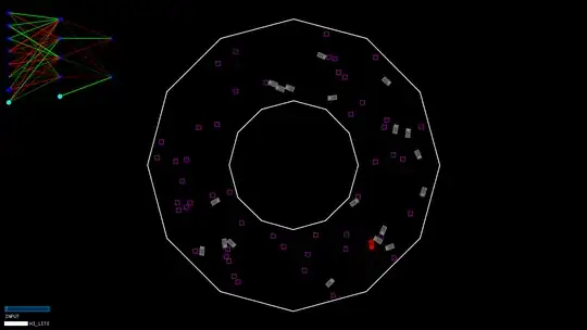

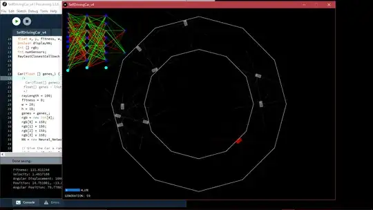

Here are some screenshots
Population of Cars in Racing Ring Revive mode (revisiting past generations of cars
