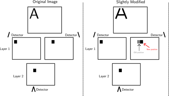

where $x$ is the original image and $T(x)$ its translated version. For example, in the following image:
our output $y$ must be the same.

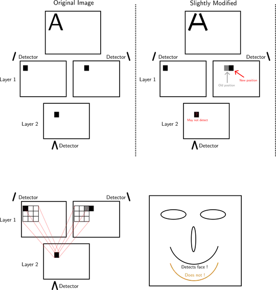

  1. Given that the feature maps of a CNN are equivariant (thanks to the convolution operation) as we translate the input these feature maps vary in the same way. That is, if a feature was present in position $x$ of the feature map, after we translate the image by $T$, it will appear now in position $T(x)$. Visualizing this:
And as we go deeper into the network where it learns to recognizes A or B, these feature maps will follow the same behavior. So assuming multiple Conv layers (reducing the dimensionality, e.g. from input 28x28 to 2x2) eventually we will get either a black (presence of A) or a white pixel (not presence of A).
  1. The case where I think MaxPooling is useful is if we consider a slightly different input image such as in the following example.
Now the \ edge has move slightly to the right compared to the /. This slight translation is captured by the first Conv1 layer. But what about the Conv2 layer? Will it be able to detect the presence of the edge? enter image description here
This might not be the case as shown in the final image. In the right figure we must detect a face, but if the relative positions are slightly changed (mouth is translated slightly downwards), then we might not detect the face at all.
However, if we use a MaxPooling layer between Conv1 and Conv2 then we will get the same feature map as in the case of the original image (putting the feature again into "focus" for the next layer).
