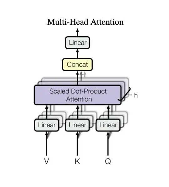

I have been trying to implement a Transformer architecture using PyTorch by following the Attention Is All You Need paper as well as the The Annotated Transformer blog post to compare my code with theirs. And I noticed that in their implementation of the Multi-Head Attention they have used three nn.Linear(d_model, d_model) to project the input of the encoder before splitting these projections into (n_heads, d_k) matrices for the attention. But as my understanding of the paper goes, we need to have n_heads of nn.Linear(d_model, d_k) for each of the queries, keys and values as we can see in the Multi-Head Attention's diagram here from the paper:

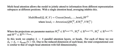

We clearly see as many nn.Linear layers as there are of heads. As well as the explanation of the authors:
Each $head_{i}$ uses $W_{i}^{Q}$, $W_{i}^{K}$ and $W_{i}^{V}$. So in my implementation I did this:
