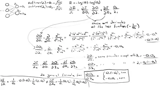

The derivation of the softmax function is a bit tricky because except the other common activation functions(sigmoid, relu...) all the Zs values impact each other. It is because when you are calculating the value of the softmax function at the denominator you are summing all the exponentials of the layer's values. For short, one input value(which could be Z1 in this case) of the softmax function has an impact on all output values(which are Os in this case).
So, you need to calculate separately for each output value(Os) with respect to on of the input values(Z1 for example) and add them to get the derivative of E wrt(with respect to) Z1. Or in other words you need to calculate the derivative of O1 wrt Z1, then derivative of O2 wrt Z1 and when you add the two values you will get the derivative of the E wrt Z1(comes from calculus).
Now let me show you the derivatives of E wrt Z1 and Z2 won't be same. Mathematical Proof
