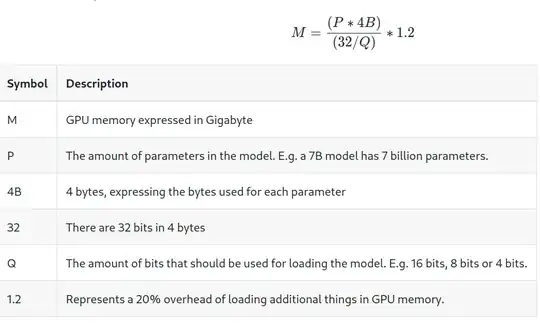

The following formula can be used to calculate GPU memory for serving LLMs: calculating-gpu-mem-formula
Source and more examples: https://www.substratus.ai/blog/calculating-gpu-memory-for-llm
Disclaimer: I'm the author of that blog
