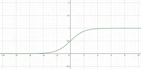

How to design the inputs:
Just create a neural network with a common pattern, figure out, what variables a real player would analyze before throwing a card, then try to translate those variables into signals. This step might actually be a bit tricky and it's also what actually happens in biological neural networks. The electrical signals in our brains are really weak, even though they might carry bits that make up big numbers. What I mean by making weak signals out of numbers is dividing varying diapasons of numbers by their maximal values. For example, instead of putting in 5, which would represent a card with rank 6, divide 5 by 13 (or whatever value represents the highest rank). Basically if your diapason of input for one neuron is 0 to 13, divide it by 13 to get a value (or signal) in codomain [0; 1], which is a suitable input for the sigmoid function compared to the values in codomain [0; 13]. To visualize, take a look at the graph of the sigmoid function.
The difference between f(10) and f(8) is ~0.00029, whereas the difference between f(10/13) and f(8/13) is ~0.034, which obviously has much more impact on the output. So, make sure you translate all the values into the diapason where your function is most "sensitive", in this case in [-4; 4]
