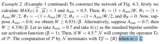

I have implemented the Translation algorithm for CILP (Connectionist Inductive Learning and Logic Programming model by Garcez, Lamb and Gabbay) from their book "Neural-Symbolic Cognitive Reasoning"
The paper which describes the example Neural Network can be found here:
https://www.staff.city.ac.uk/~aag/papers/cilp.pdf
My implementation can be found here:
https://github.com/nravindranath10/CILP_Translation_Algorithm
While the book claims that the 2 iterations are required for the Neural Network to converge to the final answer which is {B}, in my code the Neural Network seems to take only 1 iteration to converge to the same answer {B}. I have highlighted the "m = 2" line in my attached image from the book.
I would like to understand if I am going wrong somewhere in my implementation.
