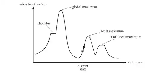

Now to your answer. Stochastic hill climbing can actually perform better in many cases. Consider the following case. The image shows state-space landscape. The example present in the image is taken from the book, Artificial Intelligence: A Modern Approach.
Suppose you are at the point shown by the current state. If you implement simple hill climbing algorithm you will reach the local maximum and the algorithm terminates. Even though there exists state with more optimal objective function value but, the algorithm fails to reach there as it got stuck at a local maximum. Algorithm can also get stuck at flat local maxima.
Random restart hill climbing conducts a series of hill climbing searches from randomly generated initial states until a goal state is found.
The success of hill climbing depends on the shape of the state-space landscape. In case there are only a few local maxima, flat plateaux; random-restart hill climb will find a good solution very quickly. Most real-life problems have very rough state-space landscape, making them not suitable for using hill climbing algorithm, or any of its variant.
NOTE: Hill Climb Algorithm can also be used to find the minimum value, and not just the maximum values. I have used the term maximum in my answer. In case you are looking for minimum values, all things will be reverse, including the graph.
