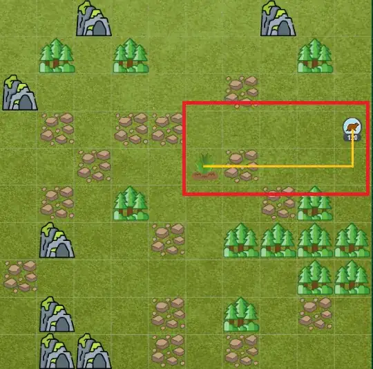

The goal is to control a game such that episodic reinforcement learning is used. In fact, the game is Mckinsey Plant-defense game. Below is an image of the game:
