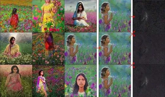

Even with all parameters fixed, I have gotten slightly different results with SD 1.4 at least when generating a batch of images. I haven't done extensive testing on this, but even a single sample is sufficient to show that the results weren't identical. The used code is a private fork from neonsecret/stable-diffusion.
Eight of the nine images were pretty much identical, but for some reason the middle row's right image showed some variation between runs on the hand. I also tried running a single image once, and this time the result was identical.
SD 1.4, "Indian girl on a flower field, digital art, realistic, highly detailed, concept art", CFG 3, 50 steps, seed 2347886331, DDIM sampler.
The gamma of difference images was set to 3.0 in GIMP, to enhance small deviations.
SD girl on field comparison
Actually it would be better to run a larger batch of identical seeds and see whether they are identical or not. I did these via copy-paste from a free SD website I run. It would be interesting to know if these results can be reproduced on different code-bases. My fork deviates quite a lot from the original one, due to several extra optimizations.
Edit 1: The image comparison is done on lossy-compressed WebP images, with a quality setting of 95%.
