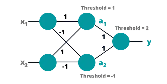

With exactly one hidden neuron, I believe the answer is no. The hidden neuron has one input and one output, and thus all it does is scale the final output by its activation function. Thus, it does not accomplish anything.
However, with a very slight tweak, the answer is yes. If we instead consider a network with exactly 2 hidden neurons, this becomes a very famous problem.
The XOR problem cannot be solved without a hidden layer, but is solvable with one hidden layer consisting of 2 neurons.
Famously, this limitation of single layer perceptrons led Marvin Minsky to be very critical of research on Neural Networks in the 1970s, and was a contributor to the first AI winter.
Here is an example of an XOR, which could not be computed with no hidden layer: enter image description here
