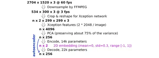

video processing pipeline

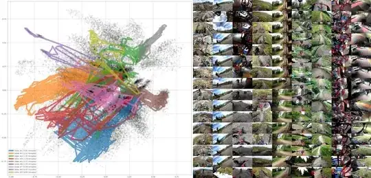

I used this for mountain biking videos, which resulted in this kind of 2D map:
clustered videos
Each line represents a different mountain biking / downhill clip. Anyway, in your case I'd use 2D coordinates for outlier detection. They seem to contain enough interesting data, and are so easy to visualize as well!
