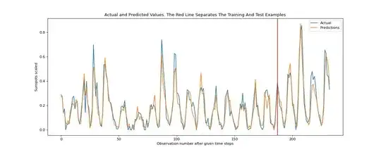

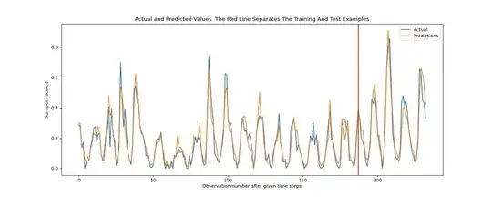

So, as one sees, the only difference is that in the model_trainable, the reservoir's weights are allowed to be updated during training, but in the model_untrainable, they are just fixed (by setting trainable=False). My hypothesis was that the model_trainable should be way better because its settable parameters are more than those of the model_untrainable. So, using identical setting for optimizers, loss functions, and regularization and taking monthly sunspots dataset into account, here are the predictivity results of the cited models.
model_trainable:
model_untrainable:
It seems that the untrainable_model is almost as good as the model_trainable. Why is that the case? In other words, shouldn't the trainable_model significantly better than the untrainable_model?
trainable = False is a hardcoded setting for each ESN layer in esn_cell.py. So, regardless of what one sets in any usage of ESN, its corresponding reservoir cannot be trained.
