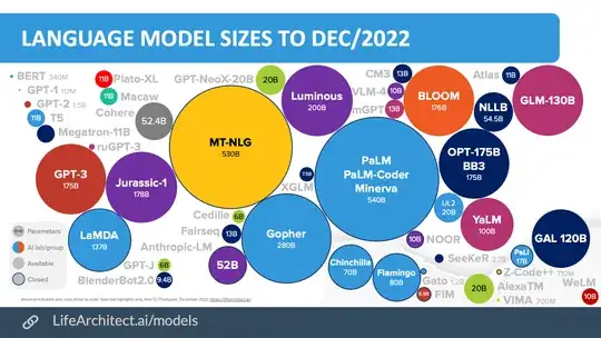

There exist however smaller language models, e.g. see this survey of small language models.
