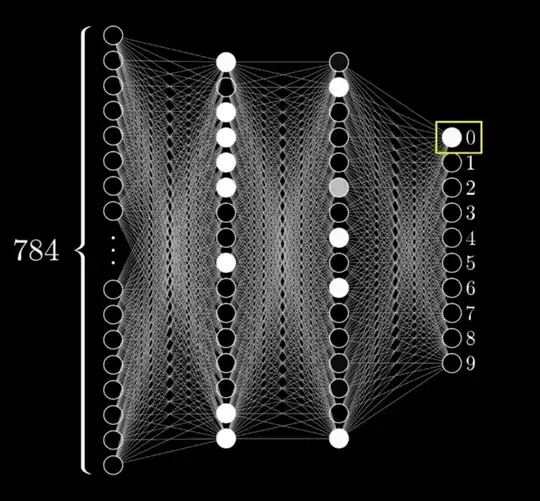

Below picture is just sweet picture that represent 10 neurons for every class in output layer: enter image description here
