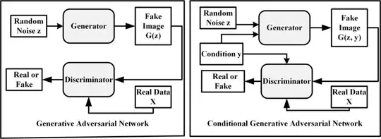

The idea of taking an additional label as input sounds like a conditional generative adversarial network (cGAN). Within a conditional GAN both the discriminator and the generator are conditioned on extra information provided through a label. The idea was first introduced in this paper.
This image from this paper nicely highlights how a conditional GAN differs from a standard GAN:
GAN_comparison
Such an architecture would likely also be suitable to be conditioned on image rotations.
