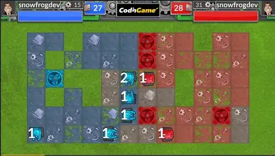

I was looking at an AI coding challenge for a two player game on a 2D grid of variable size (from one game to the next).
Here is a screen shot example of the playfield. Game played on a 2D grid
Each player has multiple units on the board. In fact, each tile can hold multiple units and you can move all or a part of those units. Each turn, each player may perform several actions at a time.
