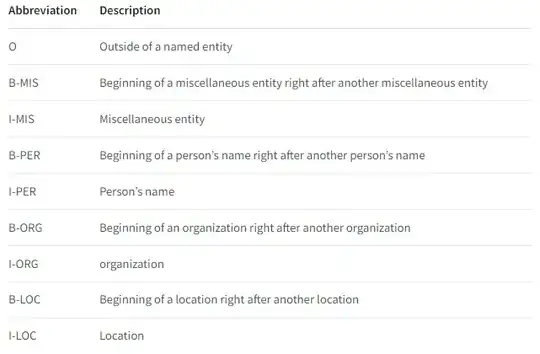

The author assumes that the reader knows the BIO tagging labels. For a reference, see this page from Hugging Face. Here is an excerpt:
