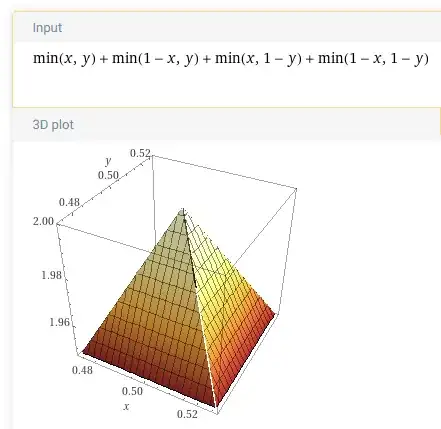

This is not the case when the conjunction is the Zadeh operator $min(x_0,x_1)$, where the sum of the four minterms happens to be a square pyramid over the unit cube, neither other possible definitions of fuzzy operators.

In the bivalued logic case the two variables $x_0$ and $x_1$ are discrete with values of either $0$ or $1$, and your four-terms sum is the disjunctive normal form (DNF) of truism whose graph is the upper half vertices of the unit cube under your context. While in the fuzzy logic with Zadeh operator case, the two variables are continuous real numbers ranging from $0$ to $1$, and the graph of your four-terms sum as you showed is a convex pyramid. One consequence is the unique maximum function value of $2$ when surprisingly both $x$ and $y$ take the value of $0.5$ instead of $1$!
