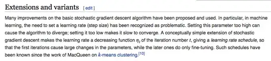

Adjusting for learning rate is a common scenario in machine learning. There is rich literature about it, countless papers. The most common implementation:
  • AdaGrad
  • RMSProp
  • Adam
There are many more variants. You'll need to do some research. Please take a look at:
https://en.wikipedia.org/wiki/Stochastic_gradient_descent
