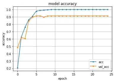

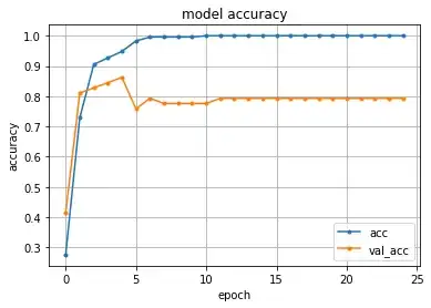

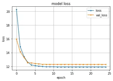

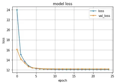

hi i'm new in this field. I am trying to do a video classification project by using 3DCNN and I plotted the loss curves & accuracy curves. I have some questions.
  1. i'm using kfold Cross validation. Should i save the parameters after every fold and choose the best one?
  2. how to reduce the loss?
  3. is it overfitting?
one of the fold
accuracy
loss
another fold
accuracy
loss

  3. Is it overfitting? Probably, but that's not a death knell for your modelling approach per se. Your graphs show that for these K-fold splits, the performance of the model on the validation set stabilises out as worse than the performance on the training set. If we can assume that the distribution of targets in these validation sets is the same as in the training set, then the model has measurably learned patterns that are unique to the training sets. Thus, overfitting.
    However, it's worth checking that this assumption of equal distributions is true - and if not I'd recommend using Stratified K-Fold Cross Validation to ensure that it is true for future experiments to make a fair comparison.
If you re-run with difference architectures, regularisation and stratification (if needed) then the generalised performance of the model may improve. There's a lot of fun experimentation to try from here, and I wish you a healthy dose luck and patience! :)
