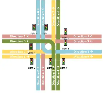

Why not use a single agent to control the intersection with the following rules:
  • define 8 traffic lights
  • Each light has two possible values, 0 or 1, with 0 = Red and 1 = Green
  • Lights are as follows:
    • 0 = North to South
    • 1 = North to East (Left Turn)
    • 2 = East to West
    • 3 = East to South (Left Turn)
    • 4 = South to North
    • 5 = South to West (Left Turn)
    • 6 = West to East
    • 7 = West to North (Left Turn)
  • map lights into a bitmap of 8 bits, with the least significant bit (left bit) is the North to south
Given the above, we have the following valid moves, which are both State Space and Action Space :
  • State/Move 0 - Vertical Moves only = 10001000
  • State/Move 1 - Horizontal Moves only = 00100010
  • State/Move 2 - Originated from North only = 11000000
  • State/Move 3 - Originated from East only = 00110000
  • State/Move 4 - Originated from South only = 00001100
  • State/Move 5 - Originated from West only = 00000011
  • State/Move 6 - Vertical Diagonal only = 01000100
  • State/Move 7 - Horizontal Diagonal only = 00010001
i.e. S = {10001000, 10001000, 00100010, 11000000, 00110000, 00001100, 00000011, 01000100, 00010001}
and A = {10001000, 10001000, 00100010, 11000000, 00110000, 00001100, 00000011, 01000100, 00010001} enter image description here Now we have a ∈ A and s ∈ S and at any given s, a will cause the next state s' to have the same value of a
Final component to complete the moel, is the reward signal, which can be simply the negative sum of time spent per car in the intersection
i.e. rt+1 = -∑ci ∈ Cars time(ci)
a single agent, will be able to optimize the solution to avoid punishment (negative value caused by wait time)
Update
You can increase the state space to double or triple its size to accommodate for time, by appending a time counter component to the bitmap. in addition to an extra (9th) action of do nothing,
This should give a more subtle traffic controller. e.g. Vertical Traffic Only, at timer = 0 can be represented by 100010000000 or in hex 880, then at time 1 = 881, and so on until time 15 to be 88F.
