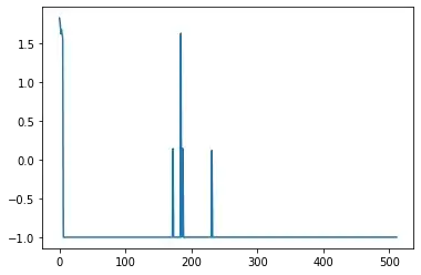

Now the problem is, the model starts from [1,1,1], then to [1,1,17], and so on! to explore this further, I plotted the prediction of the GP across the parameters and it looked sth like this (this is mean - lambda*standard deviation):
Note x-axis indices are just different sets of params, e.g. [1,1,1], [1,1,17], [1,1,33], ... As seen, there is no smoothness, and the model starts to sample every single point, you can see the random sampled points somewhere in the middle and the ones sampled through the loop near 0... why is this? what's the fix? I usually see this GP approach to produce smooth predictions, not here though!
