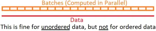

For an example of what I mean, take the following. A simple LSTM used to predict a sine wave. At training time, I can't think of any way you could use batches. As you have one timeseries here that you are predicting, you have to start at time step 0 in order to properly compute and train the hidden state and cell state.
Taking batches like in the image below and computing them in parallel will mean the hidden and cell state can't be computed properly.
And yet, in the example I gave the batch_size is set to 10? This makes no sense to me. It also doesn't help tensorflow syntax isn't exactly the most verbose...
