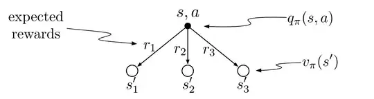

Exercise 3.19 The value of an action, $q_{\pi}(s, a)$, depends on the expected next reward and the expected sum of the remaining rewards. Again we can think of this in terms of a small backup diagram, this one rooted at an action (state–action pair) and branching to the possible next states:
Give the equation corresponding to this intuition and diagram for the action value, $q_{\pi}(s, a)$, in terms of the expected next reward, $R_{t+1}$, and the expected next state value, $v_{\pi}(S_{t+1})$, given that $S_t =s$ and $A_t =a$. This equation should include an expectation but not one conditioned on following the policy.

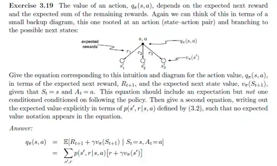

@Neil Slater In the expected answer it is said that
"This only works because you have split off the expected reward to evaluate separately. Overall, the value of $q_{\pi}$ does depend on the policy, and this is shown by using $v_{\pi}$ in the second term."
However, the following solution (from solution manual) does not support this:
