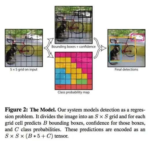

I have been reading various articles and watching videos on YouTube, but I can't seem to understand one thing.
How does YOLO make a bounding box for an object if it is in multiple grid cells? For example, in the picture given below, how does it predicts the bounding box for the classes, because they fall in multiple cells? How does it know what object is in a grid cell even when it sees a small part of it?
It's been very difficult for me to get these answers.

Lets say you split the image by 13x13 (SxS) cells. For each grid cell, you predict 5 (older YOLO) or 9 (newer versions) bounding boxes.
These (anchors) are supposed to have various shapes and scales, so they vertical, horizontal and squared rectangle at small scale, and middle scale and bigger scale.
So for each cell (13x13) and for each anchor (9) , you predict (width offset ,height offset,center x,center y, objectness, class1 ,class2,... class k ). You actually predict scaling of the width and height of the box, so you can end up with variable sizes.
Ojectness marks if there is any object in this cell for this anchor, if not, it is discarded later.
Since you end up with lot of predicted bounding boxes of various shapes, you need to filter them out, this is called non maximum supression. For each anchor you take class with highest confidence.
EDIT:
So to answer your questions, If an object is in multiple cells, it is contained in multiple predicted boxes, and you take the one with maximum confidence and discard others.
Each cell does not see only part of the image, it sees the whole image. Before you get to 13x13 cells, you have 50 or more layers of conv & max pooling layers, which gives each cell receptive field of the whole image.

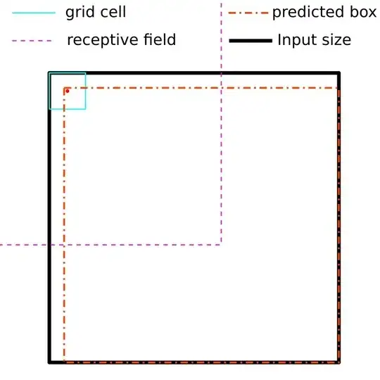

some details about the relationship of grid cell, predict box and receptive field.

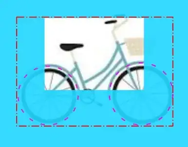

A neuron can only predict a box contains the grid cell centre, but the box size can be much larger or much smaller. The extreme case is demonstrated in following image. The predicted box can be as big as the image itself. There is no limit of the predicted box size relative to either grid cell or receptive field.
So why we allow it to predict a box larger than the input (receptive field)? Because the network can "guess" the actual box via seeing partial of the object. For example, even though we can only see part of the bicycle, we can still estimate how big the actual bicycle is:
