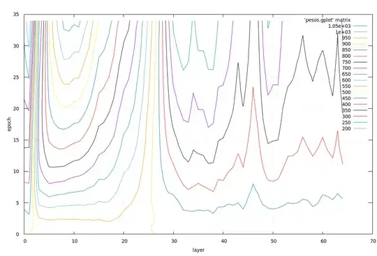

It is always possible to use a Dense layer to allow the network to built its own menu of layers
allEncoders=tf.stack([encoder[level] for level in range(1+nlayers)],axis=-1)
layerSelect=tf.keras.layers.Dense(1,activation=None, use_bias=False,
    kernel_initializer=tf.keras.initializers.Constant(0.5),
    kernel_constraint=tf.keras.constraints.MinMaxNorm(axis=1))
almostFinalEncoder=tf.keras.layers.Reshape([-1,layerUnits])(layerSelect(allEncoders))
finalEncoder=tf.keras.layers.LayerNormalization()(almostFinalEncoder)
but one must be careful with the initializer, and the vector layerSelect.get_weights()[0]needs to be monitorised.
Generically this layer will not converge to a Kronecker delta, and it must keep some extra weights open just for the sake of overfitting.

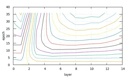

Still, the evolution seems to have some information. See here the contourplot for a 64 layers, 256 units, transformer that has reached overfitting at epoch 18 but keeps learning slowly. It seems to prefer to increase weights of layers 1 to 24, and it moves as the learning progresses, decreasing the use of the first layers.
(Sorry the colour scheme is confusing. Basically we have a descending trend in the first layers, ascending in the middle layer, then descending again in the tail)
Generically most plots show a trend to zero the two first layers (or not raising them at all if the starting vector is [0.1,0.0,...] and the growing of some peaks that can be related to the structure of the network. One of such peaks can be due to finite size, of course we can not try with an infinite number of layers and I can not imagine how to compensate for the long tail.
But it does not converge to a delta, or a set of deltas. And for few epochs it is not granted that the best peak is the best layer. You have three nearby definitions that do not seem to coincide:
  1. The layer with greatest weight in the Dense fusion of layers.
  2. The layer with best result when evaluated with a Kronecker weight (w[l]=1, w[!l]=0) in the LayerSelect class.
  3. The number of layers that give the best training in the usual, unfusioned, training.
