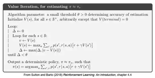

After trying to understand what was happening by going through the algorithm on paper (below), I found all values were the same, so greedifying with respect to the value function often just had the agent going around in circles. Reducing the discount factor from 1 to anything below 1 gave me 100 percent success. But going to anything below 0.9 gave me worse results in the slippery case.

Algorithm used (where $\theta = 0.0000001$):

This is expected (and optimal, as defined) behaviour with a discount factor of 1 in the deterministic case. With a reward of 1 at the end, no discounting and and no negative rewards for taking its time, the agent has infinite time to complete the task. So whatever it does, provided it does not step into a hole at any point, is optimal.
The caveat is that when following the policy as a test, you need to use random choice to resolve ties (this is assumed in the theory behind value iteration, that the agent can reach the high rewards). Most simple argmax functions will not do that, so you will need to add some kind of shuffle or other random selection over the maximum results to ensure you are really following the policy that value iteration discovered the state value function for.
The last sentence in the pseudocode is ignoring the possibility that you have this kind of situation, so it is not strictly true in all cases. That is, you cannot reliably build a working deterministic policy directly from the optimal value function when $\gamma=1$ for environments like Frozen Lake.
