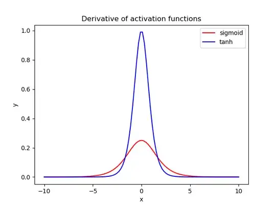

The decision about mapping the predictions to the targets range or the way around depends on the specific case you tackling. Sigmoid and tanh for example behave differently with respect to the gradients, the latter producing larger gradients, as you can see from the derivatives comparisons. So if you want larger gradients you might want to keep the tanh and map you targets to the range [-1,1]
