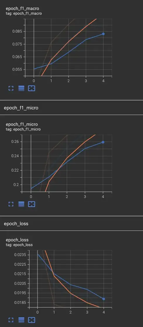

After 5 epochs results look like this (later it wasn't really improving): enter image description here

Last thing: after I saw some results with evaluation I saw that most of the outputs are empty or only 1 class, but using smaller threshold didn't increase the metric
Any idea how to improve the model for bigger number of tags? is it the metric?
