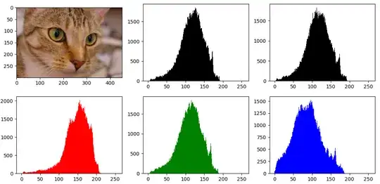

Neil is right, data augmentation is suppose to add data that respect the same distribution as the original data.
Grayscale is a linear combination of individual channel, therefore the single channels have different distributions (histograms) compared to their combination. And that is always gonna be the case, and unfortunately there's no work around to it, the only way would be to match the single channel histograms to the grayscale one, but then you'll end up with 3 copies of the same image.
You can easily check the differences with this code snippet.
import numpy as np
import skimage as sk
import matplotlib.pyplot as plt
def plot_hist(): img = sk.data.chelsea()
red = img[:, :, 0]
green = img[:, :, 1]
blue = img[:, :, 2]
gray_crt = 0.2125 * red + 0.7154 * green + 0.0721 * blue
gray_avg = img.mean(axis=2)
fig, ax = plt.subplots(2, 3)
bins = np.arange(-0.5, 255 + 1, 1)
ax[0, 0].imshow(img)
ax[0, 1].hist(gray_crt.flatten(), bins=bins, color="k")
ax[0, 2].hist(gray_avg.flatten(), bins=bins, color="k")
colors = ["r", "g", "b"]
for c in range(img.shape[2]):
    ax[1, c].hist(img[:, :, c].flatten(), bins=bins, color=colors[c])
plt.show()
if name == "main": plot_hist()
