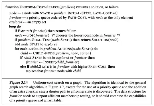

The 2nd and 3rd editions of the Russell and Norvig's book (which you can find on the web) do not have a figure for the pseudocode of A*.
However, the graph search version of A* is equal to the pseudocode of uniform-cost search (UCS), which they provide in figure 3.14 (page 94, section 3.4.2.), but, rather than using $g$ (the cost of the shortest path from the start node to $n$), you use $f(n) = g(n) + h(n)$, where $h$ is an estimate of the shortest path to the goal from $n$, which should be admissible in order for A* to be optimal. See this answer.
You can find a screenshot of UCS below.
In the pseudocode, PATH-COST is $g(n)$. When they pop from the frontier, you should pop according to $f(n)$ in A*. See also section 3.5 of the 3rd edition of the book.
